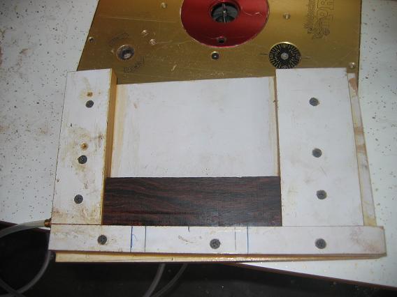

I missed the bridge jig thread a while back, so here's mine.
I built the jig last month. The jig is designed to make a properly angled slot in a standard bridge blank using a 1/8" bit in my router table.
The jig holds the blank with a vacuum clamp at the appropriate angle.
Then, the bit is raised to the appropriate height, and stops are located along the fence to provide the correct slot length. I lower the bridge fixture (with the bridge in it) onto the bit and slot the bridge.
A perfect slot!
I also have the Stew Mac jig, which is pretty good, but this is far superior. The dremel in the Stew Mac jig always has a couple inherent problems. First, I break Dremel bits when I try a full depth cut all at once. But when I do multiple cuts with the Dremel, the second cut never quite lines up perfectly with the first one, which creates just a little slop in the slot. With this jig, a full-depth cut is no problem. Perfect depth, no broken bits, perfectly straight. Woohoo!

Lance, I will someday set up a laminate trimmer for the Stew Mac jig, which is a great jig if you have to slot a bridge on the guitar. But if you have the option of slotting the bridge, it's much faster on the router table. With the Stew Mac jig, you have to set the jig up and locate it for each guitar. With the router table, you can set the bit/stops once, and then you can slot as many bridges you want at about 30-45 seconds each (if you take your time). Mass production made easy!

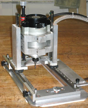

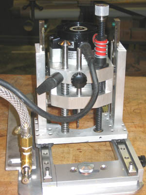

My time is primarily spent in repair rather than building, so of course my jigs have to be for mounted bridges. After using probably every commercially available jig out there and making a few of my own, this week I finally finished what will hopefully be the last one I'll ever need. I've found enough shortfalls in most of the other designs that I'm pretty sure I've got them all covered with this one.
This one is 6061 aluminum with a vacuum mounted base, Porter Cable 310 motor, linear rail bearings, plunge screw, depth stop and lock, ample room for adjustment in every direction and good visibility of the cut. It took way too long to make, but I'm pretty sure that I will be using this one for at least a few decades.

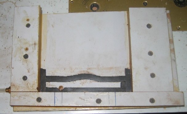

Dave, here's the pic I promised:
The hose on the left connects to a fitting that fits into a hole I drilled into the side of the jig. The drilled hole extends about 1/4 along the jig, and then I drilled a hole from the top to connect to that hole. You can see the hole in the top in the lower left quarter of the bridge blank location.
The jig is made from Melamine. The downside of the melamine is that you don't get a great vacuum unless you seal all the mdf edges, which I did with yellow glue. Now it works great!
